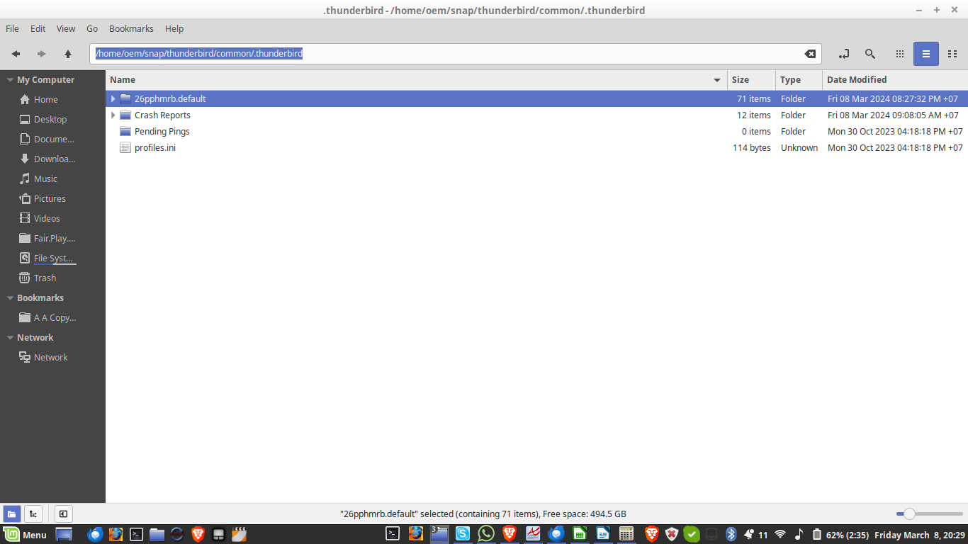

However, whenever I back up or copy the profile it does not have all the messages after October 2023 especially in pop3 accounts. In previous installations the profile was in home/.thunderbird and backing up was no problem.

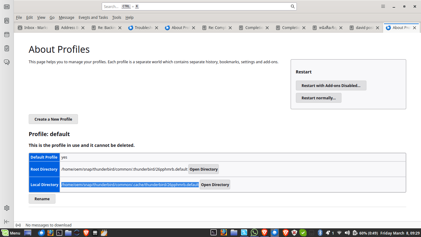

The profiles listed in this computer are below. I have backed up root but it only contains 71 folders instead of a about 150. the Local profile appears to have very little data in it.
Root /home/oem/snap/thunderbird/common/.thunderbird/26pphmrb.default Local /home/oem/snap/thunderbird/common/.cache/thunderbird/26pphmrb.default
It seems to me that even the root profile does not contain all the data and nor does the local but I cannot find another profile.

Thunderbird uses only one, although prior or unused profiles may appear on disc. To confirm which is the one being used, one approach is this: - check help>troubleshootinginformation and scroll down to 'profiles' and click 'about profiles' and that will show you the default profile.

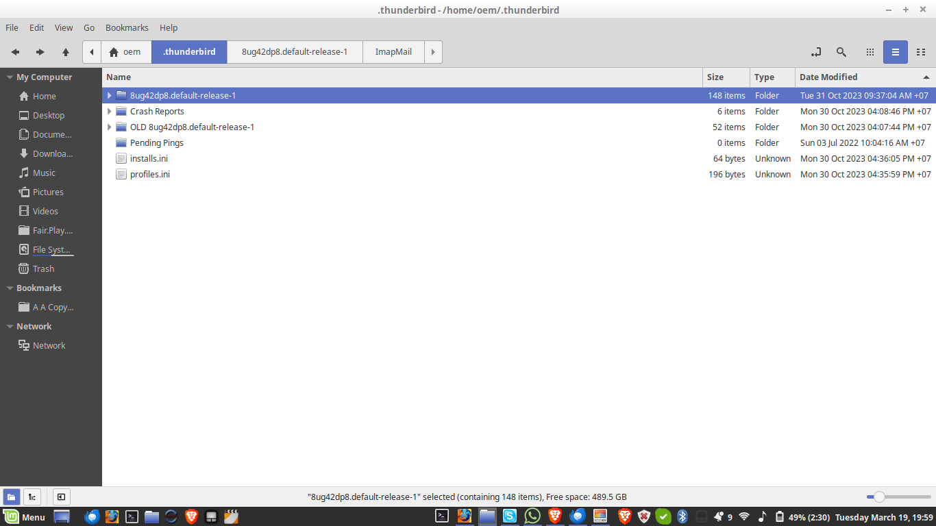

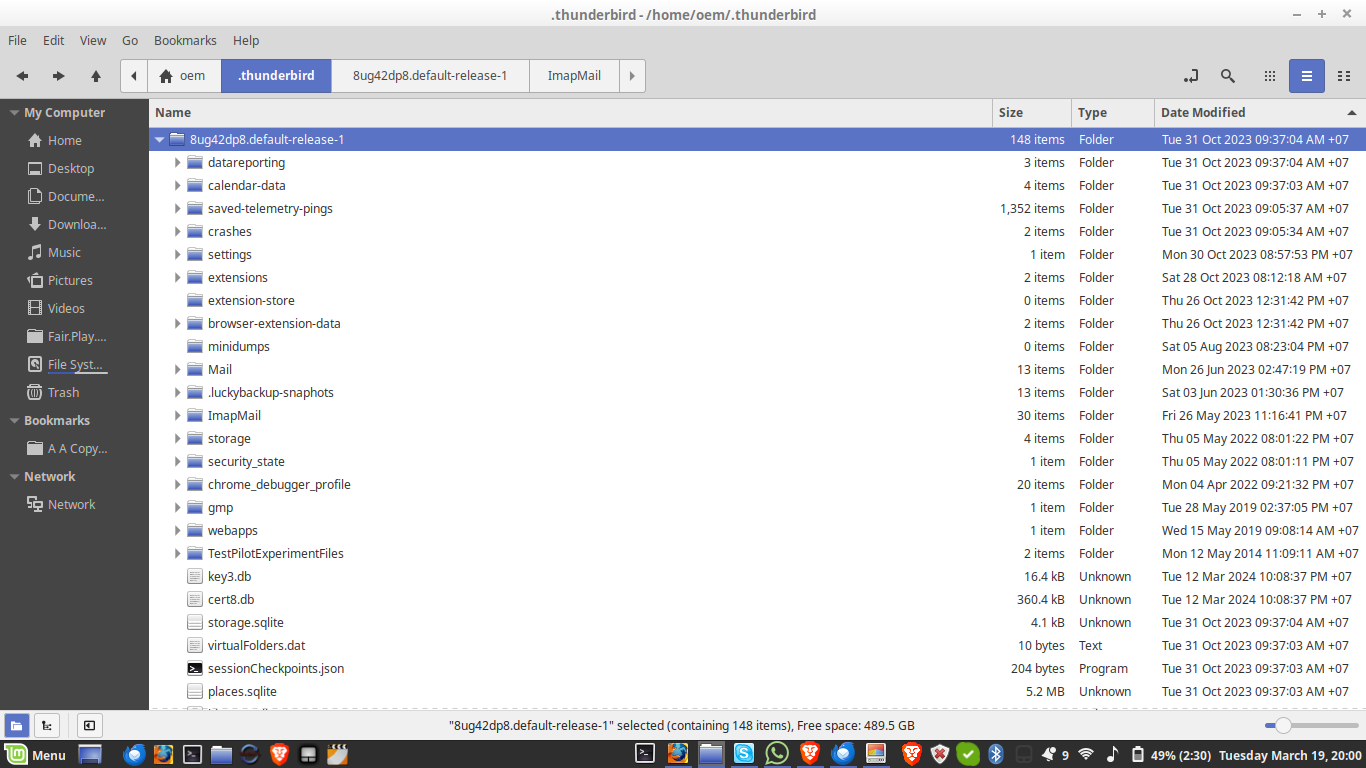

Yes - this would normally be the folder I would back up but as you will see from the screen prints it has not updated since the 31 October 20023 which has left me searching everywhere else for another profile which does not appear to exist.
So while everything on this computer seems to be normal I cannot find the profile which would allow me to back up my main computer.
I hope this helps and Thanks Again.

Originally you had a Thunderbird installation which you probably got from the official download website :
and it auto created a profile in the default location which you used for ages:
  • /home/oem/.thunderbird/8ug42dp8.default-release-1
Then you got a download of Thunderbird from the 'snap' directory which uses an entirely different location for it's default set of profile folders meaning your current version is now looking here:
  • /home/oem/snap/thunderbird/common/.thunderbird/26pphmrb.default
In this location: /home/oem/.thunderbird/8ug42dp8.default-release-1

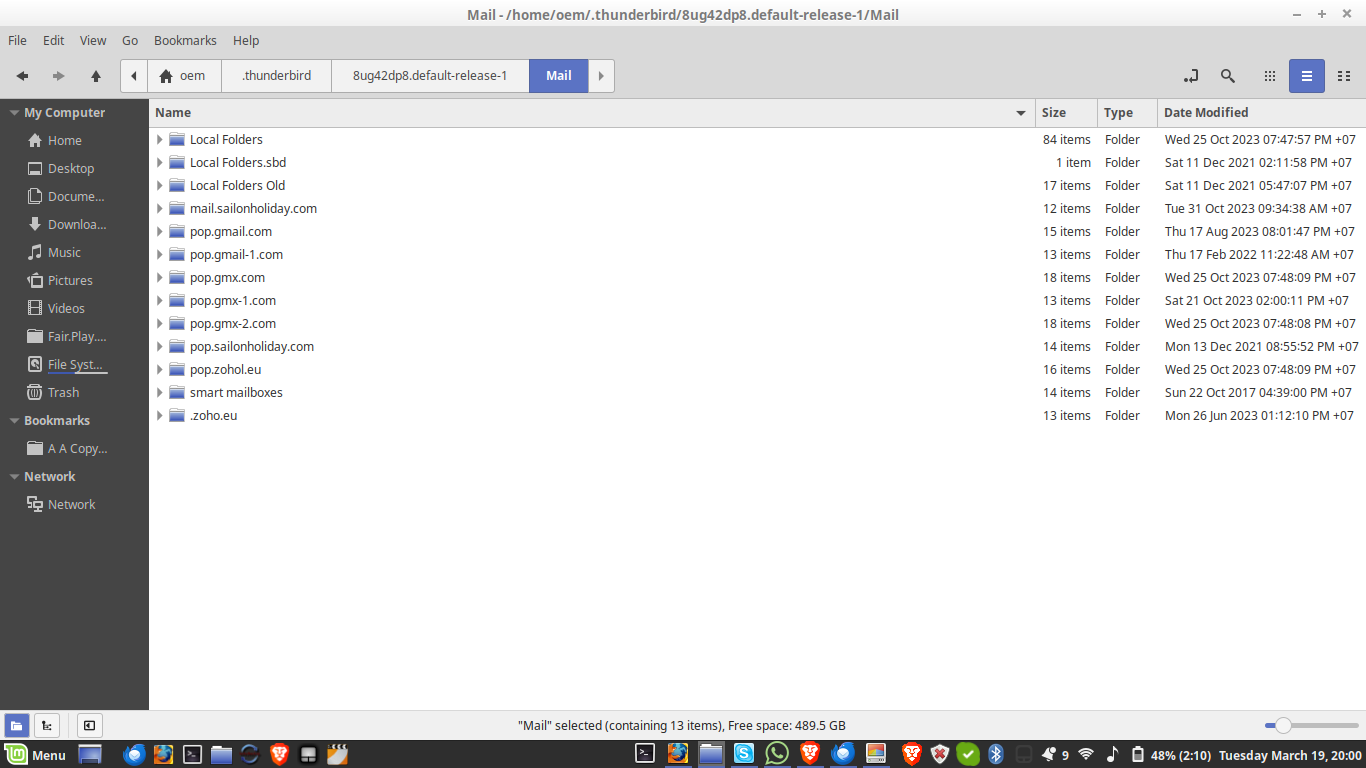

Profile called '8ug42dp8.default-release-1' - It will store a load of previously downloaded emails in the 'Mail' folder which contains all the Pop accounts and 'Local Folders' mail account.
You must exit Thunderbird before you do the following.
You can easily copy the 'Local Folders' from one profile to another: Access: /home/oem/.thunderbird/8ug42dp8.default-release-1/Mail/'Local Folders' Copy the folder called 'Local Folders'
Access: /home/oem/snap/thunderbird/common/.thunderbird/26pphmrb.default/Mail folder Remove the 'Local Folders' folder assuming you haven't put anything it OR rename it. Paste in the copied 'Local Folders' folder.
If you have emails in actual Pop accounts: You can use the Import function within Thunderbird.

This computer appears to currently hold all the email data but when I back up from the snap profile it is missing pop3 emails. When I back up /home/oem/.thunderbird/8ug42dp8.default-release-1 it only contains emails up to Oct 23.
